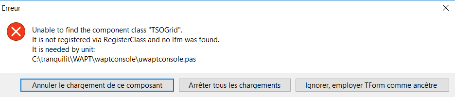

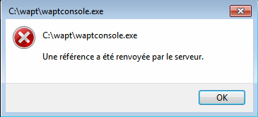

I chose to ignore the changes suggested by Simon (replacing VNC with the path to my executable) TeamViewer) and launched the compilation. After the whole procedure, I managed to generate an executable with innosetup; the installation went smoothly, but when I launch the console, I get an error:

Hi for the TSOGRID
The documentation states:
Launch CodeTyphon
. Open a package file (.lpk).
Open the following packages successively and compile them:
pltis_sogrid.lpk (IDE installation required).
Did you open the package?
Otherwise, for the reference error, try right-clicking on your WaptConsole, then selecting Properties, and in Compatibility, check "Run as administrator".

Okay, it works, I can successfully launch the recompiled console.
