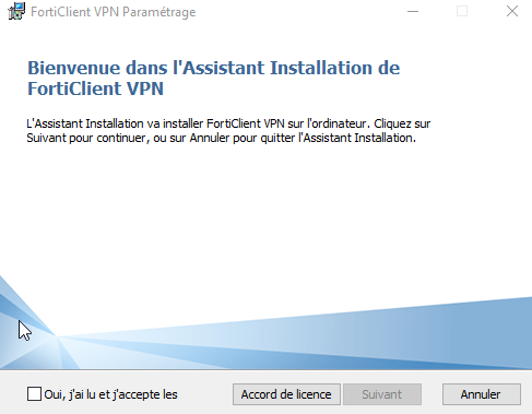

New to the WAPT field,
I am looking to configure a custom package in order to install the Forticlient_6.4.3.exe software.
I managed to launch the software from the PyScripter console (after modifying the code).
However, I can't figure out what code to add in order to accept the license terms that the software requires me to validate.
Is there some kind of magic code to validate this parameter and thus silently install the software?
Code setup.py:
Code: Select all
# -*- coding: utf-8 -*-
from setuphelpers import *
Usable WAPT package functions: install(), uninstall(), session_setup(), audit(), update_package()
# Declaring global variables - Warnings: 1) WAPT context is only available in package functions; 2) Global variables are not persistent between calls
    # Declaring local variables
    # Installing the software
    print("Installing: %s" % control.package)
    install_exe_if_needed('FortiClientVPNSetup_6.4.3.1608_x64.exe',
        '/s',
        key='',
        min_version=control.get_software_version(),
Thank you in advance for your feedback.
Anthony
Validation license forticlient.png (28.5 KB) Viewed 3461 times
Messages: 2380
April 28, 2022 - 4:21 PM
The documentation at https://docs.fortinet.com/document/fort ... ng-the-cli mentions an MSI file
. Alternatively, here's a document with an EXE file: https://silentinstallhq.com/forticlient ... -to-guide/
Hope this helps.
