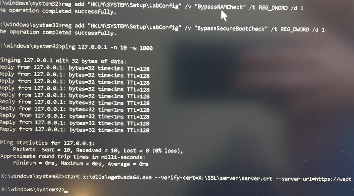

A first Dell Latitude 5290 PC was successfully deployed (including an original Windows 10 version 21H2 image, a WAPT auto-configuration file provided by default for offline Djoin + addition of a local account with autologon).
Today I tried, in the same configuration, to deploy a Dell Latitude 5530 but the deployment is stopped at the WinPE stage, with no possibility of continuing.
Error launching wgetwads64.exe
As you can see in the photo, following the ping, the executable wgetwads64.exe is called and normally launches a new terminal and continues the installation.
In this case, a terminal appears briefly, but it closes immediately.
It's impossible to restart it manually; the same result occurs.
I end up with the following result if I restart without the "start"from the beginning:
