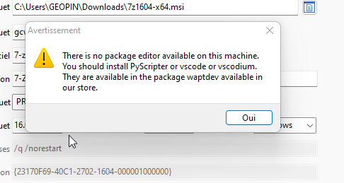

So I would like to edit my executable but it requires me to install waptdev.
Does it need to be installed on the machine hosting the console? If so, how do I do it because it appears in Package Development but not in the private repository.
Server: WAPT Enterprise 2.6.0.17226 on Debian 12;
Consoles: Windows 11
; Infrastructure: Windows
- WAPT Expert
- Messages: 2027
Hello again,
you need to install the waptdev package on the machine where you have a configured console; it will be simpler (ideally, you should use a different machine than the one you use for daily management, but this will do for now).
The waptdev package will install pyscripter3 on your machine. Pyscripter is launched by default with elevated privileges. Depending on the user account used for the console and local UAC configuration, you will need to enter a user account with local admin rights (necessary for testing the installation).
In pyscripter, you can test the installation and uninstallation of the application. After that, to upload the package, the best way is to use the console interface, in the "Private Repository" tab, and select "Build and Import Package into Repository".
Regards,
Regards,

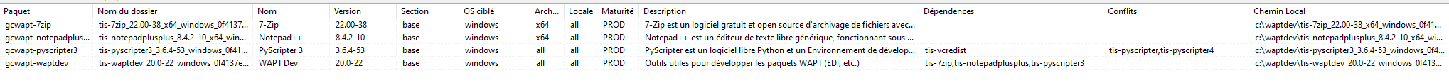

I had to manually install Python and PyScripter on the machine hosting the WAPT console.
Our configuration, which we are currently testing, consists of:
a Hyper-V Windows Server 2019 VM (WAPT server outside of Active Directory),
a Hyper-V Windows Server 2019 VM (Active Directory Server),
and a Hyper-V Windows 10 Pro VM (WAPT Agent) – a test machine for testing package installations. There is also
a physical machine with the WAPT console (outside of Active Directory). On this machine, it is impossible to install packages (e.g., Waptdev) via the console.
I log in to the console with the admin account created during the WAPT installation.
