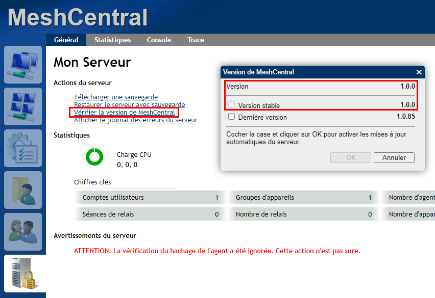

September 16, 2022 - 4:24 PM
Indeed, version 1.0 seems safer.
For your information, you can switch releases graphically from the web interface.
2022-09-15 16_22_20-MeshCentral.png (97.79 KB) Viewed 14073 times
