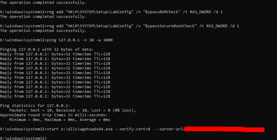

When deploying the OS to a machine via IPXE, a message about certificate verification appears, then nothing else happens.
Is the problem with my certificate?
How can I bypass this issue and continue the OS deployment?

Can you rerun the last command without the "start" so that the error message remains?

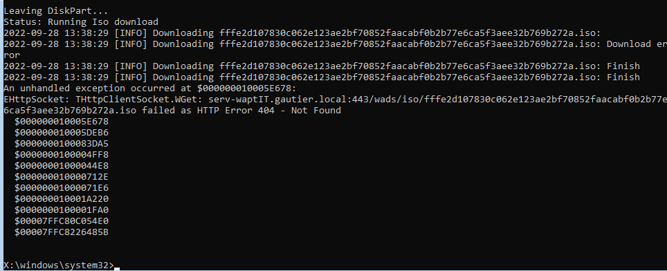

Here is the error message.
I believe I saw in some of your threads that if the ISO file is too large, it can cause this type of malfunction. Is that correct?
- Attachments
- Error Cert-2.png (28.25 KiB) Viewed 8632 times
- WAPT Expert
- Messages: 2380
If you're using a standard Windows 10 ISO, there shouldn't be any problem.
You'd need to check on the server to see if the file actually exists, since it's a 404 error.

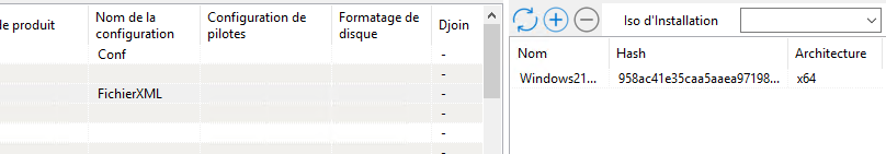

Hello Denis,
there's absolutely nothing in the /var/www/wads/iso folder...
Yes, my image was successfully integrated into the WAPT console
- Attachments
- iso console wapt.png (15.74 KB) Viewed 8604 times
- error iso.png (1.89 KiB) Viewed 8604 times

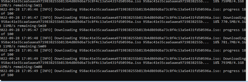

After restarting the server (because restarting the nginx service is not enough) the iso is downloading.
All that's left is to cross our fingers...
Thank you for your help
- Attachments
- Download iso.png (40.63 KiB) Viewed 8595 times
