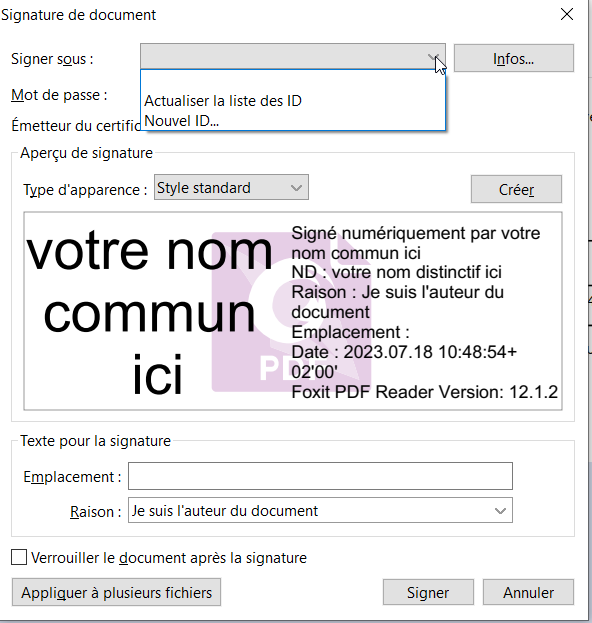

I opened a PDF document. I went to
the "Protect / Place Signature" menu.
Once the signature rectangle was placed, nothing appeared in the ID list (see attached copy).
Thank you for your help.
Have a good day.
Have a good day.
- Attachments
- 2023-07-18 10_51_02-Clipboard.png (55.14 KB) Viewed 11969 times

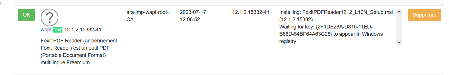

thank you anyway for analyzing the problem.
Although I don't agree with the solution,
the registry has been completely cleaned (see the result after installation).
The wapt package has been completely removed and reinstalled.
Not entirely convinced by the answer, I will continue my investigation.
Have a good day.
Have a good day.
- Attachments
- 2023-07-18 16_50_09-Registry Editor.png (8.38 KB) Viewed 11944 times
