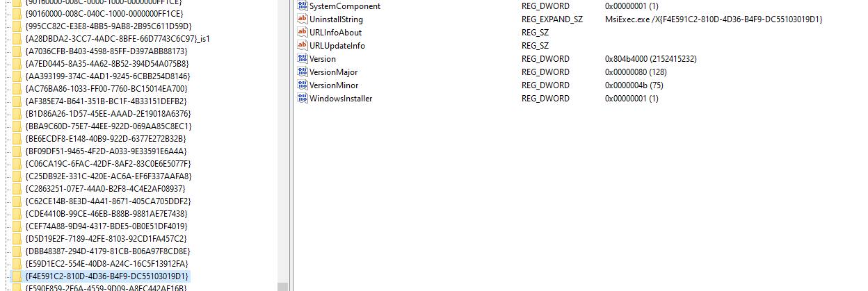

For example, to uninstall an executable, you will find an uninstallation key in the wapt console after installing your software.
This uninstallation key corresponds to a registry key that you can find in regedit.
Within this registry key, you will find an 'uninstallstring' line which will point to the uninstallation command. There is a function called 'uninstall_cmd()' in the setuphelpers module that allows you to use this uninstallation key.
But this doesn't always work. Sometimes it's necessary to run the uninstallation command directly within the script using a subprocess.
To uninstall a portable application, you will need to delete the entire folder and desktop shortcuts.
I hope this has helped you.
