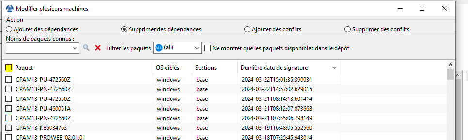

We would like to create a package that would clean/purge the dependencies of the remote package on each machine
Both packages at the depot and older ones:

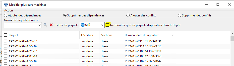

If that's not possible, we've found that the checkbox:
It did not work for multi-selection.
Indeed, when we remove packages from our repositories, if some machines have kept dependencies in their remote package, the latter returns an error because it can no longer find the dependency.
Do you see any mass action that could be taken?

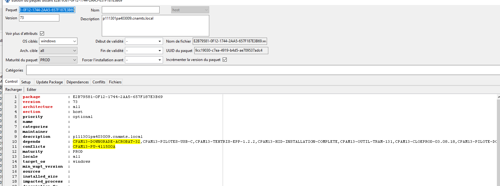

Hello everyone,
A little update on the topic.
Our idea is to be able to remove the "depends" from the machine package control file:
Thank you for your advice.

Messages: 2027
May 3, 2024 - 3:58 PM
Hi Flavien,
if the problem only affects a few packages, you can select multiple/all machines and right-click / "Edit multiple machines". Then check "Remove dependencies", select the dependencies you want to remove, and click OK.
