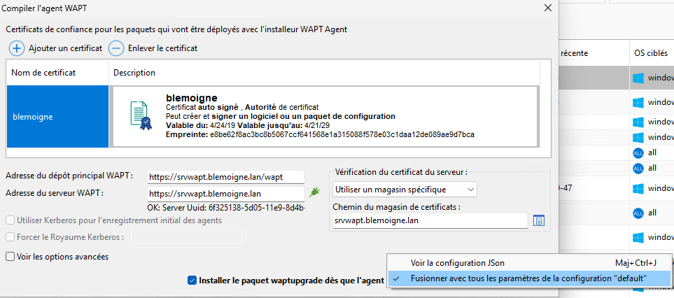

In the discovery version, it's more complicated. It's possible to modify the file C:\wapt\waptserver\repository\wapt\conf.d\default_*.json located on the server to add the "service_auth_type" property to the existing dictionary.
Next, create the agent and right-click on the window > Merge with all default configuration settings:
