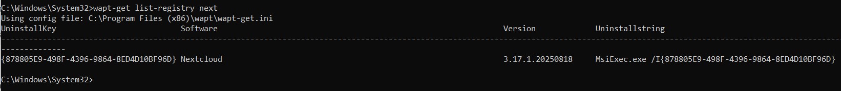

It's strange because I'm not experiencing the same issue (and it's affecting my entire network in the same way).
Just to be sure, I completely uninstalled Nextcloud manually from my machine. I checked with "wapt-get list-registry next" that there was no longer any mention of Nextcloud in my Registry, then reinstalled the WAPT package on my machine. I'm getting the same error as before, with a different uninstallation key than yours: "wapt-get list-registry next" again gives me the key "{878805E9-498F-4396-9864-8ED4D10BF96D}" for my version 3.17.1.20250818 (see screenshot).

Thanks for your reply.
I'm not sure what else to try.
