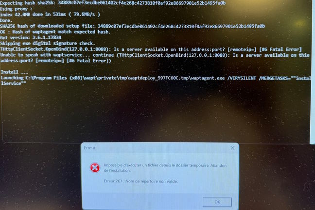

Problem:
Automatic deployment via GPO is not working. After the workstation starts, the GPO is correctly applied. However, the agent installation does not start.
A temporary folder is created at each startup in:
C:\Program Files (x86)\wapt\private\tmp\waptdeploy_xxxxx.tmp
. waptagent.exe is the only file in this folder.
However:
waptservice is never installed
; wapt-get.exe is not present;
the workstation does not appear in the WAPT console.

I also tried
enabling "Always wait for network at startup and logon," unfortunately without success.
It seems that waptdeploy.exe correctly downloads waptagent.exe, but never actually starts its installation when run as a GPO startup script.
Have you encountered this behavior in version 2.6.1.17834, or do you have any suggestions?
WAPT agent deployment via GPO
- WAPT Expert
- Messages: 2380
We've identified this problem with some clients. It's visible if you allow the startup scripts to be displayed in the Waptdeploy GPO.
Waptdeploy downloads the file to a tpm folder.
The EDR detects that the installation directory is a temporary directory simply because the word /tmp/ is in the path.
In newer versions of Wapt, we've modified the directory to remove /tmp/, and that seems to be working better.
What EDR do you see in your case?
