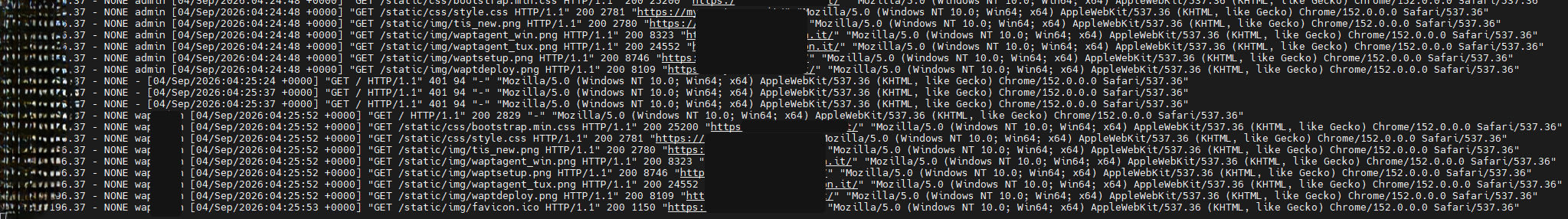

1. Although I can authenticate via the console with all existing users (I only have one user in addition to "admin"), I cannot authenticate at the WAPT server web interface level. It repeatedly prompts me for a login/password request regardless of the user (even with "admin") as if I were entering incorrect credentials (I have copied and pasted them several times to be sure).
I tried changing my user password via the console and restarting the services on the server, but that didn't change anything.

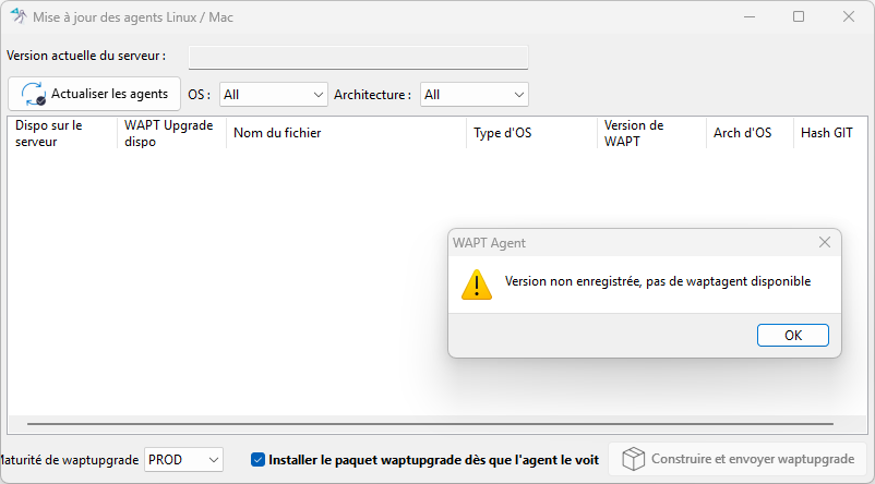

2. Following the postconf, I was able to regenerate a wapt agent via the console for the Windows machines (no problem and the agent updated correctly on the machines), however, it was impossible to "download and send the WAPT agent installers to the server" (for Linux and Mac) via the console.
I tried once without success, then I ran the script "get_linux_and_macos_agent.sh" and tried again from the console, still without success.
I'm getting this error message:
Basically, that's it... if anyone has any ideas... I'll continue to look into it on my end.

do you have Kerberos authentication enabled on the server side?
Are you using Chrome/Chromium for the web interface?
If so, could you try with Firefox?
There's a difference in behavior when encountering a 401 status between the two browsers.

We've fixed both issues:
A release is planned soon (before the end of the week)
https://wapt.tranquil.it/wapt/nightly/w ... -c88b2627/
htouvet
Messages: 444
Registration: March 16, 2015 - 10:48
September 1, 2026 - 5:06 PM
Version 2.6.1.17870-d3b9238d is released with the 2 fixes.

To answer (a bit late, I know), yes, I am indeed using a Chromium-based browser (I did see in the Nginx logs that I was getting 401 errors, but without any further details...). I installed Firefox and, unsurprisingly, there are no authentication issues with the server's web interface.

Just a quick update: following the update, I was able to update the Linux/Mac agents without any problems.
Using a Chromium web browser, the web interface is accessible with the admin account, but I still get a 401 error with the second user account (the local account on the WAPT server), which works fine, of course, if I use Firefox.

b.ald wrote: ↑September 2, 2026 - 7:44 PM Just to give a quick update, following the update, I was able to update the Linux/Mac agents without any problems.
With a Chromium web browser, the web interface is accessible with the admin account, but I still get a 401 error with the second user account (local account on the WAPT server), which of course works if I use Firefox.
This was corrected on 2-6-1-17870 [1].
Sorry for the inconvenience :-)

My bad, indeed, I tried again and I can authenticate (using chrome) with the user present in the "htpasswd".
But I couldn't say why, it only works on the second attempt... the first attempt always fails as you can see in the screenshot (the three 401 lines correspond to the first attempt, and the following one works...)
That's just a minor detail. Anyway, thanks again!
