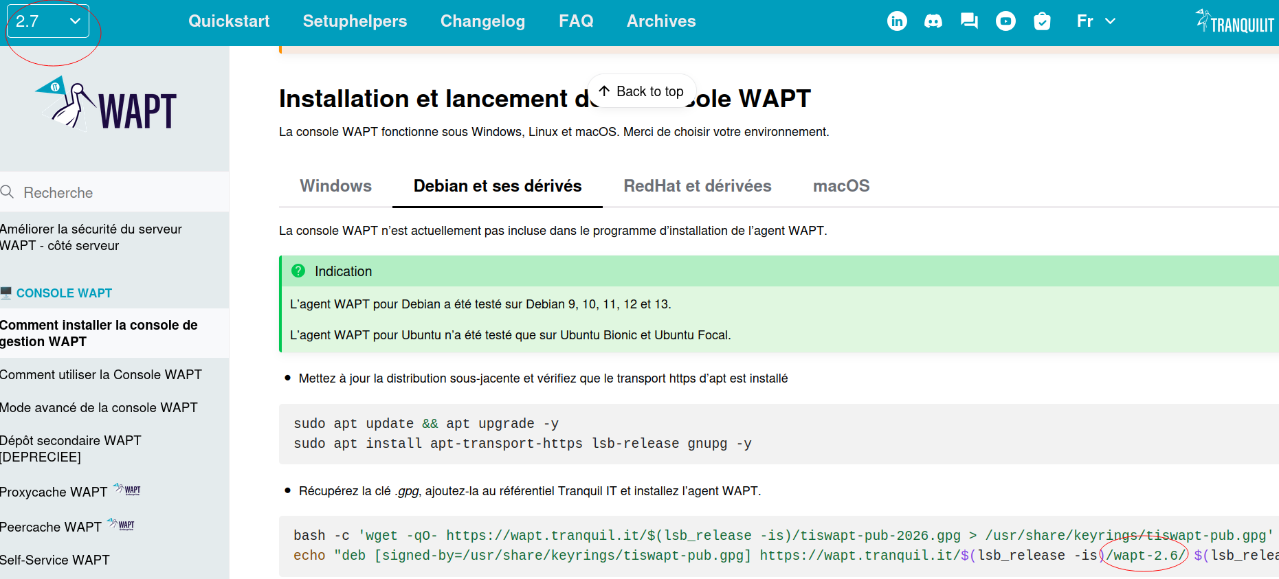

As indicated in your documentation
, "The WAPT Console must be installed on the administration workstation from which you manage your network."
The console and the tranquil.it repository are exclusively on our administration machines, which are running Ubuntu.
Indeed, the documentation isn't entirely up-to-date (see the attached image):
https://www.wapt.fr/fr/doc-2.7/wapt-configuration.html
Have a good afternoon.

indeed there is a GUI to download the agents and create the update packages in the console, but it might only be available in the enterprise version.
For now, you can retrieve the .deb files from the provided URL. For the admin workstations, they have the agent installed but not attached to the WAPT server?
The best approach is to build the agent upgrade packages from the console and assign them to the workstations (removing the source apt configuration from the agents).
