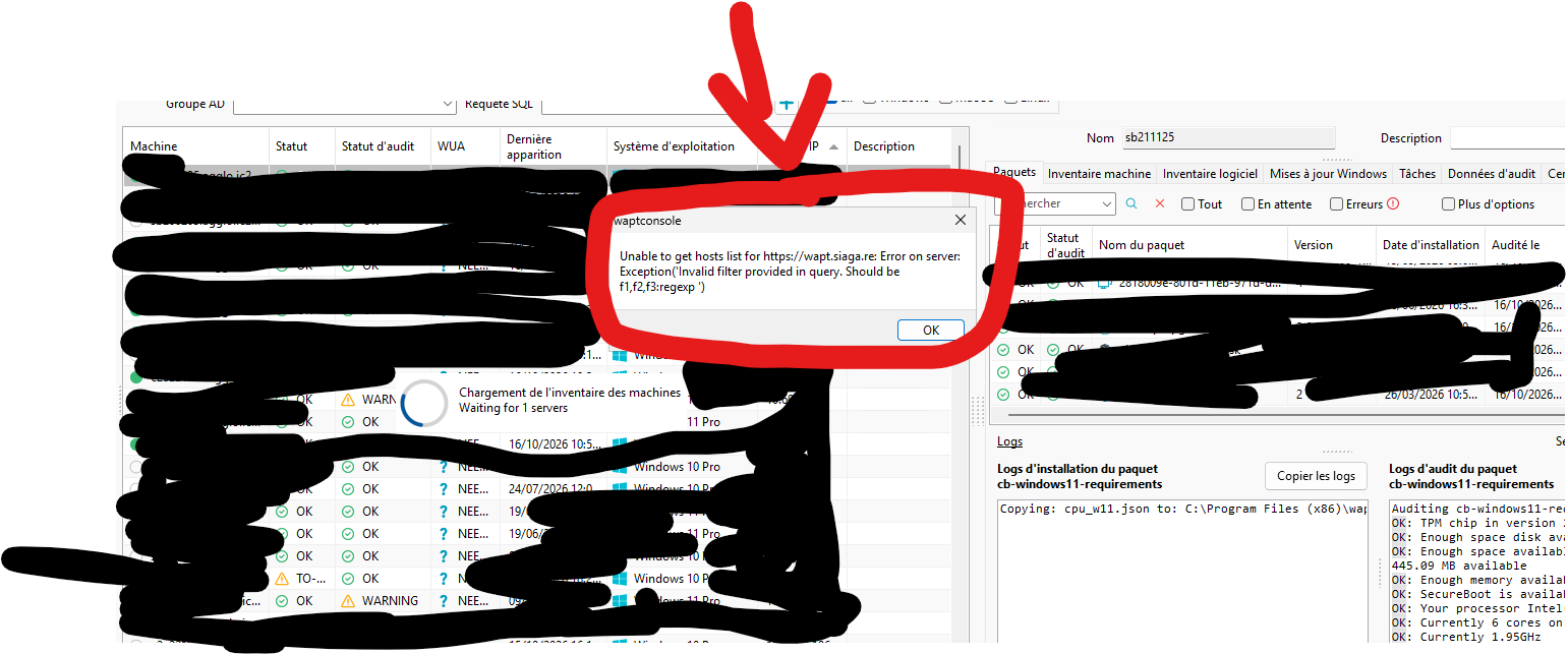

Following the update of my console to 2.7.0.19598, I tried to search for a PC to see if one existed, but now I get this error message:
What should I do while awaiting your reply?
Thank you in advance.
Catherine.
Console updated to version 2.7.0.19598
I encountered this problem when I displayed "more options"
by default; no box was checked below in the search criteria (neither machine, nor software, nor packages).
Therefore, you either need to uncheck the "more options" box, or you need to select at least one search criteria box.
- WAPT Expert
- Messages: 2376
Good point!_Yoann_ wrote: ↑Oct 16, 2026 - 4:40 PM Hello,
So either you have to uncheck the "more options" box, or you have to select at least one search criteria box.
I hadn't noticed; I'll make a note to correct that internally.
