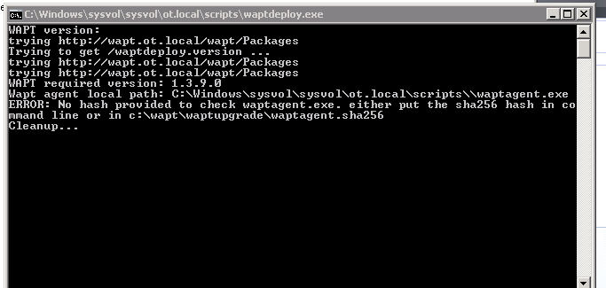

After following the documentation I created the GPO but the script is encountering a problem with the following error code (see attachment).

As stated in the documentation, WAPT Deploy expects a checksum, a hash, to verify the integrity of waptagent.exe which it will have to download and execute.
Therefore, your command line becomes:
Code: Select all
waptdeploy.exe --hash=70d90ca28d89052b0492b76e021c3dda13daedff --minversion=1.3.8 --wait=15
That should work better.
You can test this manually using the command line. Also, is your call to waptdeploy.exe correctly using a network UNC path? (e.g., \\server\scripts\waptdeploy.exe)

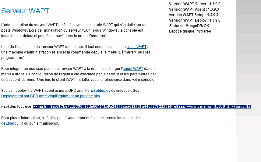

Just a quick note: the hash is different for each generated agent !
You need to retrieve the hash displayed in your WAPT server's web interface.
That should work much better.

I just restarted the hash process as indicated in my documentation (something I did the first time) and here's the result:
For your information, here is the hash I have on my deployment server (it is not the same as the domain controller server, does that change anything?).
