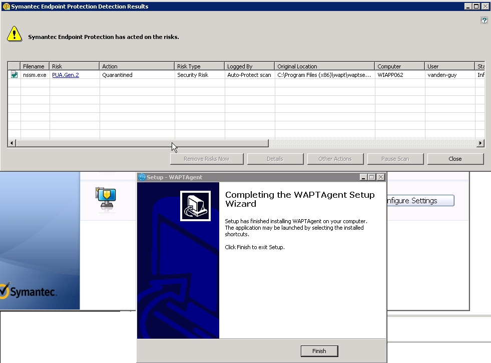

the problem seems to be affecting agents as well, due to NSSM...
An exclusion seems to make the WAPT client functional, requiring a complete reinstallation...

This does not appear to be sufficient.
The service is correctly registered, but the nssm.exe executable is deleted during installation by waptdeploy.exe.

It's definitely an antivirus problem
