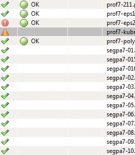

- WAPT version installed: 1.7.3.5
- Server OS: Windows 7 Pro
- Client machine OS: Windows 7 Pro 32-bit
Hello everyone,
on my WAPT server with the latest version, I have all the computers on the console, but on some workstations, there's no green "reachable" icon. I can't figure out where the problem is coming from. The client workstations are set to the same time as the WAPT server. Can you help me, please?
A screenshot is attached.
Thank you in advance, and a big thank you again to the entire WAPT team.
Sincerely,
CHISFE
