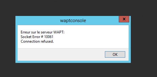

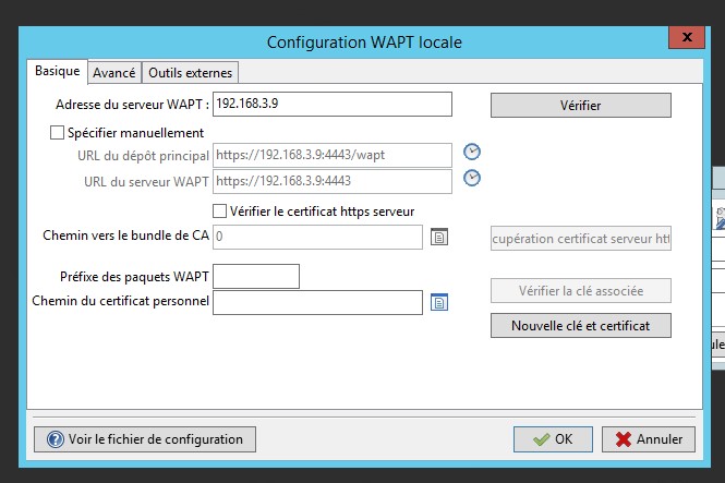

Hello everyone,
I have been trying for several hours to complete the installation but I am stuck, and I cannot find the cause.
Wapt server is installed on a virtual machine under Hyper-V, Windows Server 2012. Static IP address: 192.168.3.9
The steps taken are:
- Installation of WAPT Server version 1.7
- Modifying listening ports (via the Nginx conf file and in Wapt-get)
- Modification of firewall rules
- Added Aliases and CNAME
I think the problem is due to my server URL being incorrect. Thank you in advance for your help.

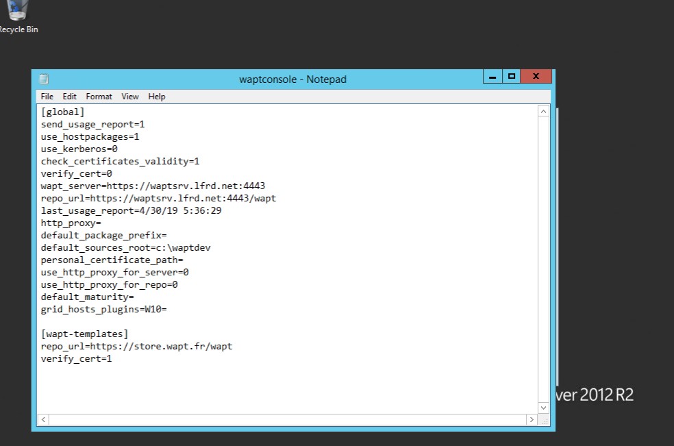

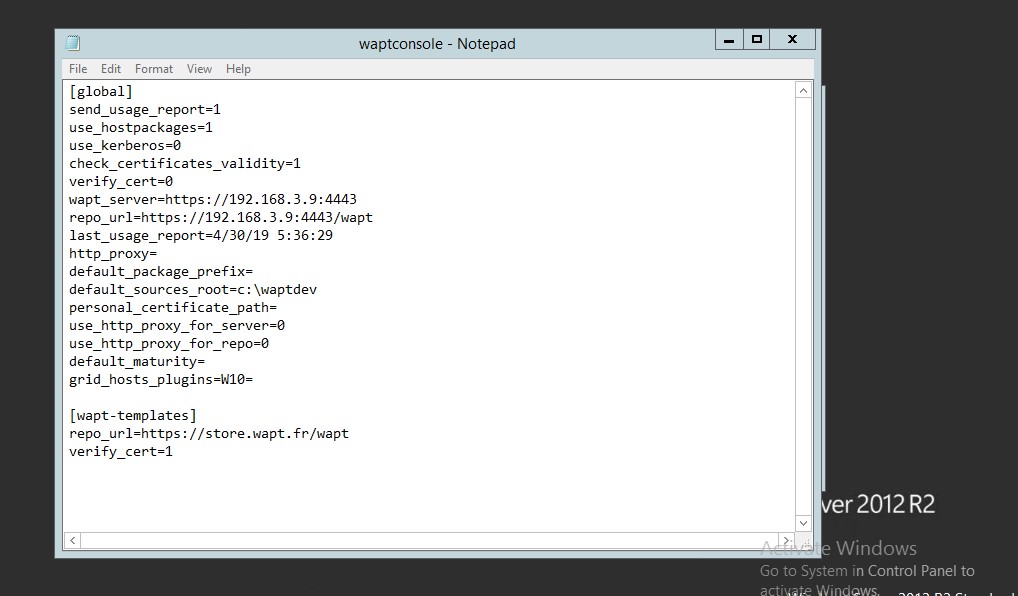

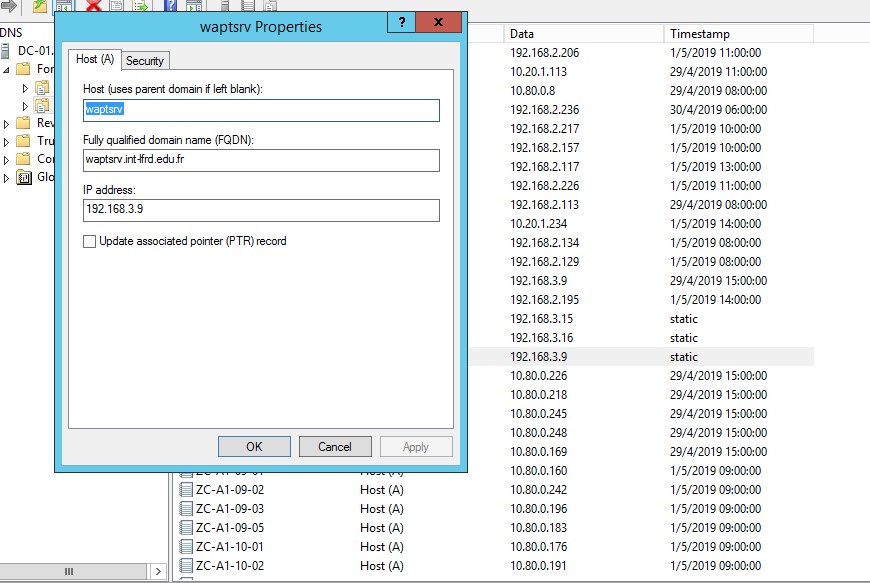

May 1, 2019 - 10:23
I also tried using the associated DNS name (the machine is called waptsrv and our domain is lfrd.net)
I entered the IP address on our Firewall (pfsense), linking waptsrv to our domain.
Same result...

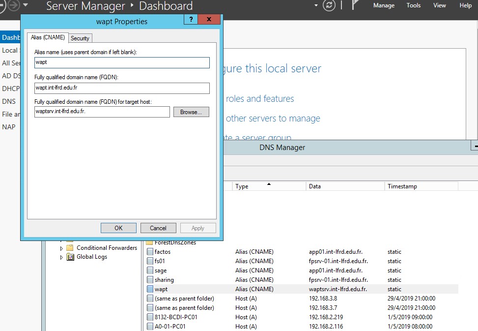

PierreM
Messages: 13
Registration: May 1, 2019 - 03:39
May 1, 2019 - 10:24
Alias ​​and CNAME
Thank you again in advance.

Messages: 2380
May 24, 2019 - 10:53
There's a small error in our documentation; two ports are mixed up:
4443 and 8443.
TCP 0.0.0.0:8443 waptsrv:0 LISTENING
[nginx.exe]
The documentation uses port 8443 as an example.
You need to modify the following on your system: C:\Program Files (x86)\wapt\wapt-get.ini
repo_url=https://wapt.mydomain.lan:8443/wapt
wapt_server=https://wapt.mydomain.lan:8443
