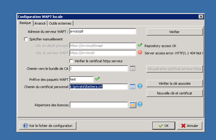

Hello, I recently installed Waptserver version 1.7.4.6077 on a VM (Windows Server 2008). I completed the entire installation, but when I try to authenticate, I get the following message: "Error on the WAPT server: HTTP/1.1 404 Not Found."
Any ideas on how to resolve this issue? Thank you in advance for your help.

My crystal ball is broken, but my intuition tells me there's already a web server other than WAPT's running on this machine. If that's not the case, we'll need a bit more context to find an explanationGlasgow wrote: ↑June 24, 2019 - 4:56 PM Hello, I recently installed Waptserver version 1.7.4.6077 on a VM (Windows Server 2008). I completed the entire installation, but when I try to authenticate, the following message appears: "Error on the WAPT server: HTTP/1.1 404 Not Found."
Any idea how to resolve this issue? Thank you in advance for your replies.
Sincerely,
This morning I was able to access the console without any problems, but recently it's back to the same message as yesterday and I can't access the WAPT console

To verify Denis's theory:
Verify that port 8088 is listening on the machine:
The order must return:
The value 3916 represents the ID of the process that is using the port.
To verify that it is indeed the WAPT server using this port, you can list the processes and filter by the ID returned previously using the command:
The same applies to ports 80 and 443, but in this case, it shouldn't be waptpython.exe that responds, but nginx.exe
You can also provide us with the status of the WAPT service in services.msc

Thank you for your response
For port 8088, the order returns
and indeed the find me command returns
Ports 80 and 443 are responding correctly to nginx.exe
Code: Select all
TCP 127.0.0.1:8088 0.0.0.0.0 LISTENING 1660Code: Select all
waptpython.exe 1660 Services 0 57 452 Ko- Attachments

Oops, my mistake, try with port 8080 and not 8088
- WAPT Expert
- Messages: 2380
You should carefully reread the first recommendations on this page: https://www.wapt.fr/fr/doc/waptserver-i ... index.html
