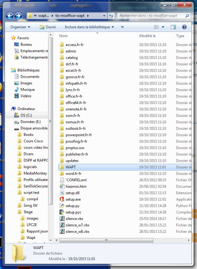

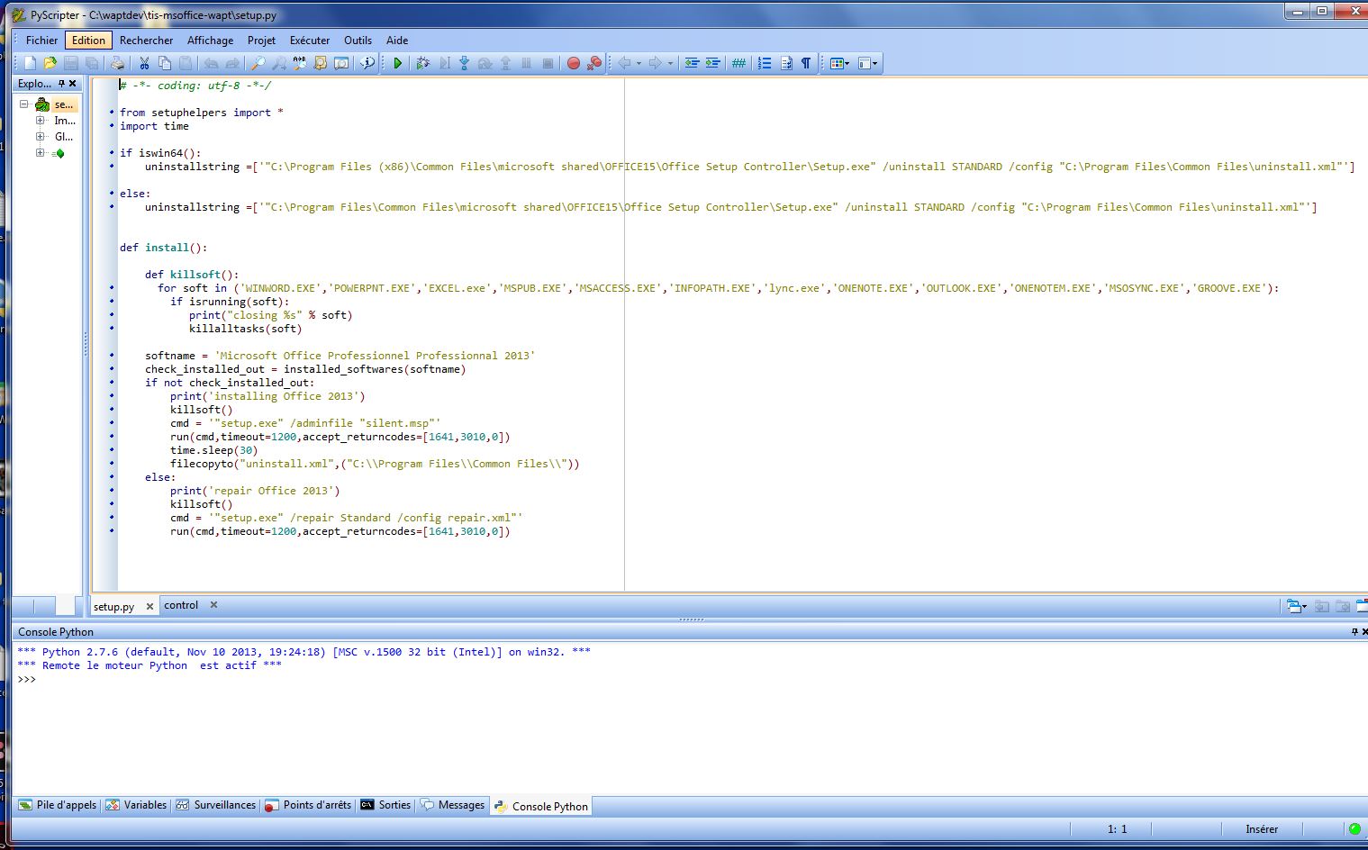

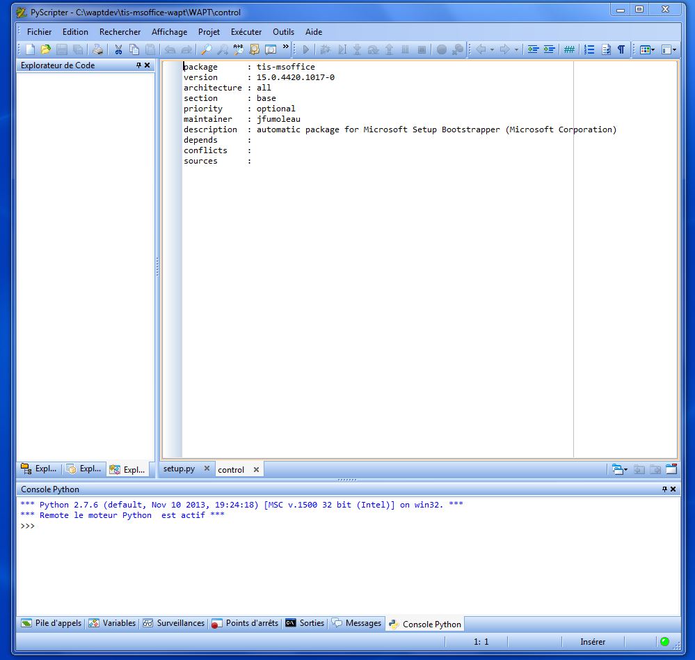

I tried modifying my setup.py file by using a script (originally designed for standard MS-Office 2013) adapted for MS-Office 2013 Professional. I created the wapt package and uploaded it to our private repository. Then, I deployed it to a test computer. The package loads correctly, but during installation (which takes some time), it reports errors and fails to install.
I think I'm missing some elements in my script. Furthermore, I'd like to integrate a VBScript to activate KMS and the license.
Could you provide me with the necessary information (the "errors" or "missing elements") to successfully complete the installation? Thank you.
I'm attaching screenshots.

You are missing the silent.msp repair.xml and uninstall.xml files in your package dev folder.
Create the silent.msp file using the command c:\waptdev\my-msoffice-proplus-wapt\setup.exe /admin
Add well SETUP_REBOOT Never when creating the msp file, as in this link:
http://www.adminarsenal.com/admin-arsen ... installation
The content of the XML files is as follows:
The product needs to be modified depending on the version
The uninstall strings are not in the correct location; the lines should be present in `def uninstall():` or in an `uninstallstring` with program files variables
The repair is not mandatory
Alternatively, you can use this example package:
http://wapt.lesfourmisduweb.org/wapt/sm ... 0_all.wapt
You will need to slightly modify the package if you wish to use a version other than the 2013 pro plus.

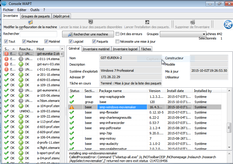

Thank you for your quick response.
I'm getting an error on the WAPT console while monitoring the task execution.
I get the message: "installing 'package name'" for a while, without any installation taking place on the client, and then the message: "PackageEntry 'package name' unavailable" appears.

Could you please send a screenshot of the console as shown in the attached image?
Could you also confirm that the package appears correctly in "private repository"?
