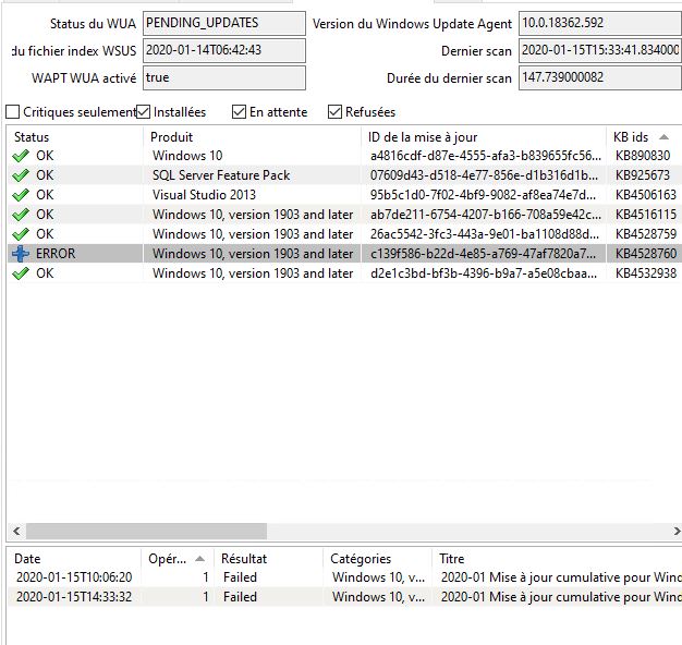

January 16, 2020 - 3:57 PM
Now it's this update that's causing the problem:

And does manually installing the cab resolve the issue? (to understand what's wrong)
Is the installation failure systematic across the entire network?
mart03
Messages: 47
Registration: December 26, 2017 - 11:03
January 16, 2020 - 6:39 PM
Indeed, the update cannot be installed manually. And I've noticed that a small number of PCs in the network are unable to install it.
