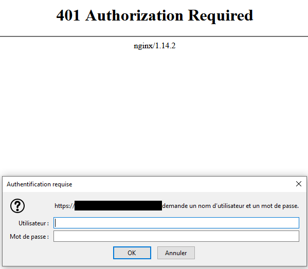

Test results:
2020-02-27 08_00_32-401 Authorization Required.png (15.72 KB) Viewed 17203 times

After configuring Kerberos authentication in Firefox, you do have a ticket in the klist (in the user environment, not psexe)?
If so, the Python part of WAPT is not the issue (given the 401 message).
You could try uninstalling libnginx-mod-http-auth-spnego and reinstalling it with this deb:
https://wapt.tranquil.it/debian/wapt-1. ... _amd64.deb

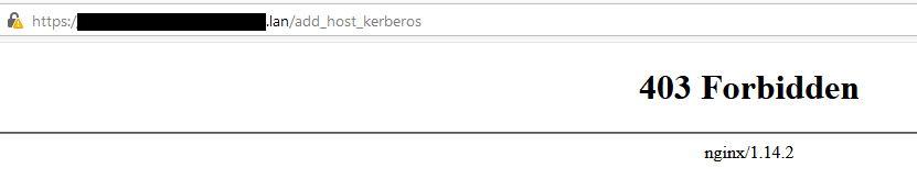

However, I have a question:
When configuring the Firefox server, do I absolutely have to include my domain name? What difference does it make if I don't?
Because it's not the same mistake if I don't include my domain name.
If I enter my domain name, I get a 403 error:
2020-02-27 14_34_21-403 Forbidden.png (7.55 KB) Viewed 17191 times

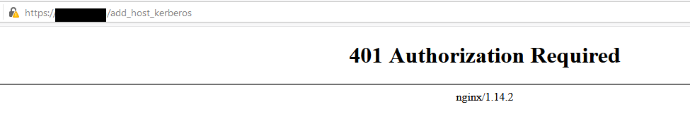

If I don't include my domain name, I get a 401 error:
2020-02-27 14_36_49-401 Authorization Required.png (9.9 KB) Viewed 17191 times
