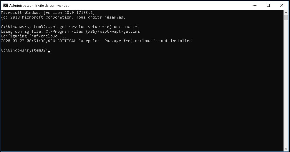

I ran your command line on my virtual machine which is supposed to have owncloud installed by deployment.
Result: package not installed (see attached) even though the program itself is properly installed.
In your code, from the wapt console, I used print() to retrieve the variables: get_current_user(), url_owncloud, and application_data(). The correct values ​​are returned.
The machine I'm deploying to doesn't have administrator privileges. I don't know if that matters during the deployment process?
It seems the folder and file creation isn't working, which is preventing me from writing the parameters. However, I'm not getting any error messages. I'll try your code and create a folder on the desktop, for example, to see if that works, and I'll let you know.

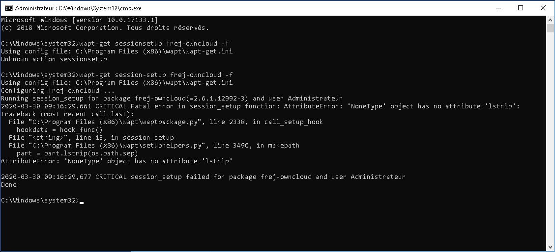

Here's the actual screenshot. Sorry,
any idea what the error is?
For me, there seems to be a problem with the `makepath` function, but from the server, when I print the `makepath` variables, I get the correct result.
But I still have a question: Apparently, when I deploy OwnCloud, neither the OwnCloud folder nor the .cfg file is created until I click the desktop icon. The WAPT script must create the folders and the .cfg file so that everything exists on the first run. Is that what the script does?

The %HOMEPATH% variable should not work on your PC
It would be necessary to replace
Code: Select all
homeowncloud = makepath(os.environ.get('HOMEPATH'),'ownCloud')
by
Code: Select all
homeowncloud = r'C:\Users\%s\ownCloud' % get_current_user()

March 30, 2020 - 2:34 PM
It seems to work, at least it works on my test machine :D
. THANK YOU THANK YOU THANK YOU.
