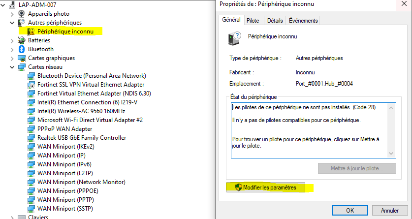

However, copying via wapt does not install the drivers for the interfaces (Esao Plus Console). This is a device that is connected via USB to run the software.
When the console is plugged in, the USB device is not recognized by the device manager:
USB interface not recognized.png (55.35 KB) Viewed 6886 times
Since the users don't have administrator rights on the machines, they can't update the driver. Furthermore, I have at least 70 machines where I need to install it...

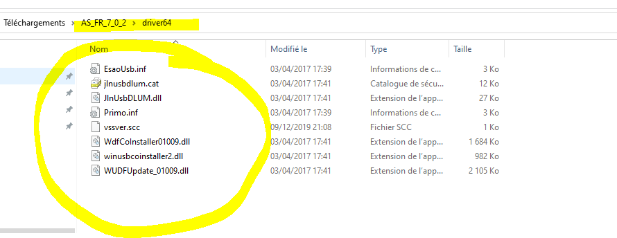

I have the drivers in a folder but I don't know how to deploy them via Wapt.
console drivers.png (31.47 KB) Viewed 6886 times
Do you have any ideas, methodologies or suggestions? I'm open to all suggestions.
