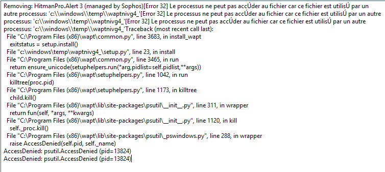

first error (antivirus)

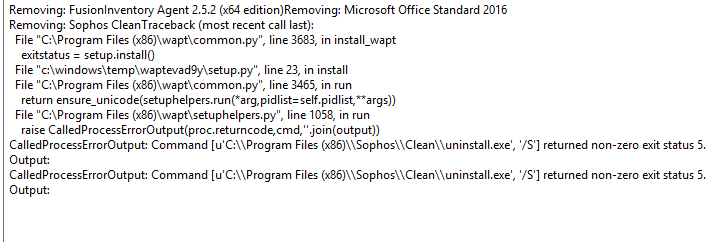

After adding an exclusion to my antivirus to resolve the first error, an error persists during several Removing steps described in your package.
second mistake
second mistake

The first problem seems to be an antivirus issue (the installation file is locked by another process).
The second problem comes from the antivirus uninstallation process itself (sophos clean). It returns a return code of 5, which is not standard. If this is a normal code, it should be added as an allowed return code in the package (see documentation); otherwise, we need to investigate why it's malfunctioning.
