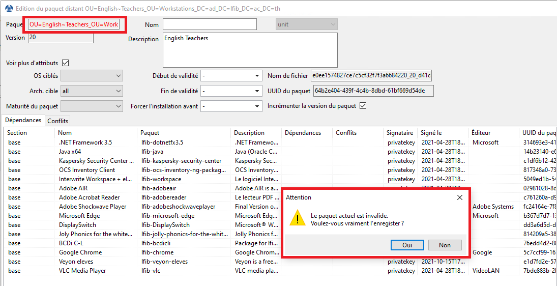

My OU (unit) packages are displayed in red and I get this message when I try to update them.
In practice, when I upgrade packages, they do not upgrade on the machine packages; the unit/machine link is no longer established.
I re-signed the unit packages but it didn't change anything.
It appears that these are all the OUs that have a space, and I have a large number of them.
What to do:

Hi David,
there was indeed a name sanitization that was a bit too drastic. Spaces are being removed for software packages, but apparently this was also applied to OrgUnit packages, which shouldn't have been the case. Thanks for reporting this bug.
I'll check with the developers to get a quick patch; there's not much to fix, it will just require reinstalling the console, the logic on the agent side shouldn't change anything.

I apologize for contacting you again, but this is indeed causing real problems with the sub-OUs. Some packages are no longer recognized during updates and are not being downloaded to the sub-OUs, conflicting packages are not being applied, and there are quite a few bugs, mainly with synchronization between the OUs and sub-OUs. This is becoming complicated for us.
The same issue arises with access to Veyon; we use it for maintenance, and the right-click functionality made our lives much easier.
Do you think you'll be able to release a patch soon?
