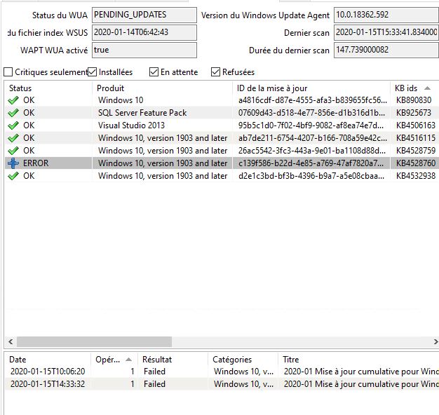

by mart03
Now it's this update that's causing the problem:

by mart03
Indeed, the update cannot be installed manually. And I've noticed that a small number of PCs in the network are unable to install it.
