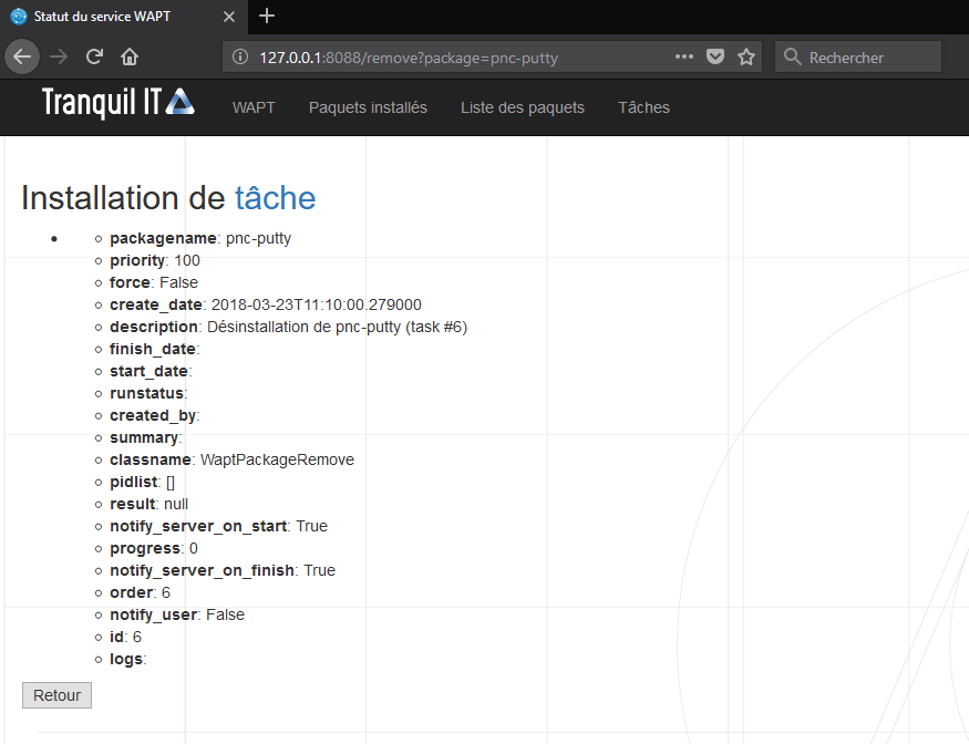

Second, I've encountered an error in how the pages are displayed:
The package uninstallation page doesn't seem to depend on the correct file. When I uninstall a package, I naturally end up on the page 127.0.0.1:8088/remove (see Remove.png).
As you can see, the uninstallation message is incorrect.
After some research and testing, I discovered that the content of this page (which should depend on remove.html) actually depends on install.html, which is most likely the cause of this problem.
This doesn't affect the package installation/uninstallation process, but it's a problem when trying to customize the view of each page independently (the remove.html file doesn't seem to be used).

PyLEVEQUE wrote: ↑March 23, 2018 - 11:55 AM Then I encountered an error in how the pages are displayed:
After some research and testing, I discovered that the content of this page (which should depend on remove.html) actually depends on install.html, which is very likely the cause of this problem.
It doesn't affect the package installation/uninstallation process at all, but it's a problem when you want to customize the view of each page independently (the remove.html file doesn't seem to be used).
I should mention that I'm on version 1.5.1.21.
Yes, it's a bug. I'll create an issue in Roundup to make sure it's not overlooked. It should be fixed in the next minor release.
