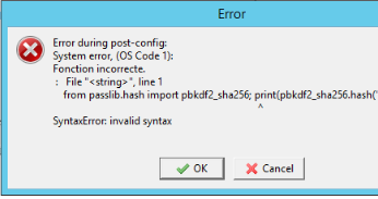

By using a domain administrator account during post-configuration, I inherit this message.
And this by trying with the old wapt, having previously deleted the old wapt, with the antivirus, without the antivirus, with vc++ 2008 or without VC++2008.
Las.
I logged in with the local administrator account.
And I have this error
The image capture is truncated because the password appears in plain text in the error pop-up.

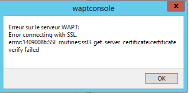

But upon logging in, this message appears:

For the "SSL connecting error" message, you need to click on the small wrench icon and then click on "Check".
This is indeed indicated at the end of the Debian documentation, but not at the end of the Windows documentation.

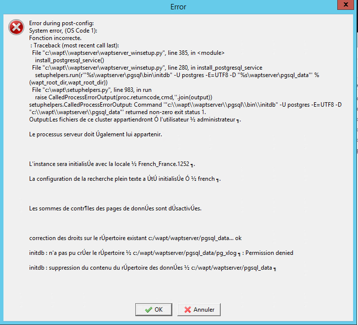

And this is the error message I'm getting.
I started again and, in addition, I deleted the c:\private directory
And I'm still getting the same error message.
I'm giving up.

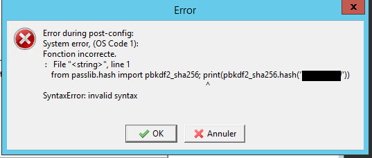

I performed the same procedure on a fresh install of Windows Server 2012 R2
And the message is repeated again:

What special characters are in your password? It seems the Python call in waptserverpostconf.exe is probably buggy in this case. Could you use an alphanumeric password for the initial installation, and then change it in the waptconsole after the installation is complete?.

Why? Because the error messages said it couldn't change the permissions on a directory.

. During installation, I entered a simple password.
Why? It seems that strong passwords weren't accepted. And I'm wondering if this isn't related to a restriction that appears after installation, stating that passwords must be at least 10 characters long.

The only issue I'm encountering is with the password. A fix is ​​in progress for this.
You probably have a password containing a single quote (') or a double quote ('). The problem doesn't occur in the Linux version.
