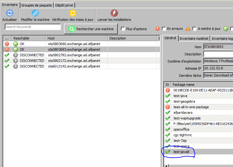

I understood the concept, but my problem is:
Is there a server command that allows adding a package to a user for installation?
For example :
wapt-add-usrpackage sta5803693 test-java8
and thus obtain it here
This function would be used on a web panel with a user system
Sorry for asking so many odd questions
