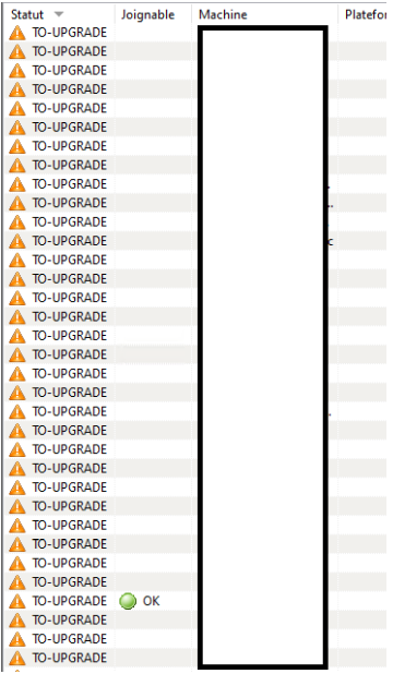

I just finished upgrading to 1.8, however, my entire network is no longer visible. When I say visible, I mean that they detect all of my networks as disconnected (reachable) (except for about fifteen machines)...
I've reset the WebSockets and cleared my console cache, but still nothing.
Thank you for your help.

I'm coming from version 1.7.4.
Here is an image of my console attached.
Annotation 2020-01-28 181214.png (106.54 KB) Viewed 13669 times
While all of my workstations are reachable via their IP address.
There are some positions that reappeared after a restart.
THANKS

the package is showing as TO-UPDATE, but it doesn't indicate that the machine is reachable. This morning most PCs were reachable, so I think the daily reboot was enough for the console to "see" them again. There's nothing alarming in the debug logs, at least no errors at first glance.
I'm marking this as resolved.
Thanks :)
