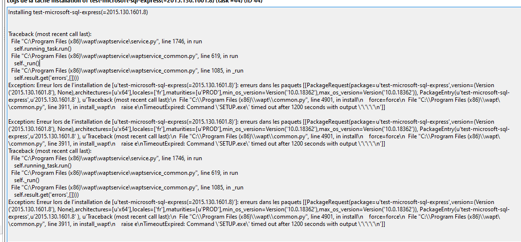

I've been working on installing SQL Express 2016 for a few days now. I created the configuration file for a silent installation, and it works locally. I copied all the contents of the SQL setup folder into the WAPT package. However, when I deploy, I get a significant error, and no files are installed on my client.
Here is the error and my setup.py.
Has anyone managed to install it or encountered a similar error? Thank you very much!

Thank you for your response
I tried using the "required" options from the Microsoft documentation, but it didn't work. So I copied my entire configuration file like this:
Code: Select all
    install_exe_if_needed("SETUP.exe",'/Q /IACCEPTSQLSERVERLICENSETERMS /ACTION="install" /ROLE="AllFeatures_WithDefaults" /ENU="False" /IACCEPTSQLSERVERLICENSETERMS="True" /QUIET="True" /UpdateEnabled="True" /USEMICROSOFTUPDATE="True" /FEATURES=SQLENGINE'      (le reste)........
result, "returned non-zero exit status -2068052377."
I can't figure out what this error code means.

I successfully completed the installation, so I'm going to share the steps I followed for those who need them!
So I created my SQL Express 2016 configuration file (start an install then cancel it, easy to find on google), I removed QUIETSIMPLE e and put QUIET = TRUE.
Then I put everything as is in the setup.py file
Code: Select all
    install_exe_if_needed("SETUP.exe",'/ACTION="install" /ROLE="AllFeatures_WithDefaults" /ENU="False" /IACCEPTSQLSERVERLICENSETERMS="True" /QUIET="True" /UpdateEnabled="True" /USEMICROSOFTUPDATE="True" /FEATURES=SQLENGINE etc....
I put the contents of the installation folder into the package.
The problem was that during each "test" installation, I hadn't completely removed all traces of the software, hence the error message. After a complete uninstall, it works.
