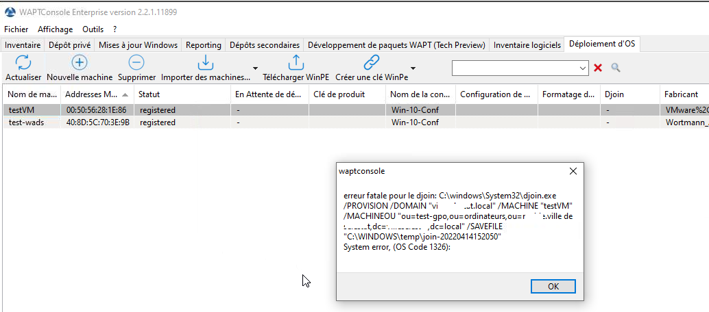

After following the webinar, I tested a Windows 10 Pro deployment and I get this error on both a VM and a PC:
- pb-join.png (50.03 KB) Viewed 15968 times
Nothing under c:\windows\temp\joi-......
I tried creating the computer account in the OU, but it didn't change anything. The PC doesn't go into deployment waiting mode
Any ideas you'd like to suggest?

Hello bruno67,
error code 1326 indicates an authentication problem. I assume you entered the correct password, so the problem lies elsewhere. In the console, the credentials are used to perform local privilege escalation to run the djoin command. There may be encoding issues during the credentials transfer for privilege escalation:
* What login format did you use? `identifier` and
`identifier@mydomain.lan` work, but `MYDOMAIN\identifier` is buggy (to be fixed in a future version)?
* Does the domain have anything unusual (connection to a RODC, trust relationship, etc.)?
* Do you have an unusual special character in your password? (We've already had conversion problems between local machine encodings and UTF-8)

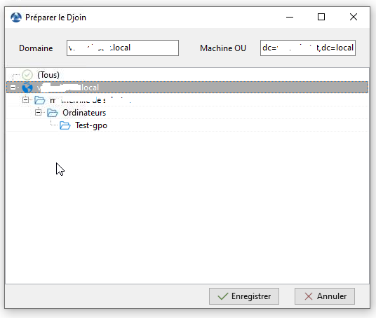

What I find strange is that during DJOIN, when choosing the OU, only one appears: 'test-gpo'
- djoin.png (22.27 KB) Viewed 15903 times
while I have dozens of OUs above

Regarding the display of OUs, it currently relies on OUs already used by workstations integrated into WAPT. We will add an option in the future to retrieve other OUs even if there is no WAPT workstation within them.

Not knowing where to begin with the deployment problem, which was failing to start due to random errors (1326, missing data in the configuration file, etc.), I ran a new `apt update` and, as if by magic, my first deployment started

djoin is a Windows executable, so it's Windows that's returning this code.
It would be interesting to run the command directly in a command prompt to see exactly what Windows says.

Here is the command in different "states"
: Console launched with a local administrator account and cmd as a local administrator:
Console launched with a local administrator account and cmd as a domain administrator:
Console launched with a domain administrator account and cmd as a domain administrator:

for the first one, that's normal; djoin needs an account with domain privileges to create an account.
For the second one, there's clearly already a machine with the same name, so you need to add /reuse, otherwise it won't work.
The same goes for the third one.
Anyway, for some reason, /reuse doesn't seem very reliable in djoin.exe. We'll suggest deleting the entry before recreating it with djoin in the console; I think that will be simpler.
