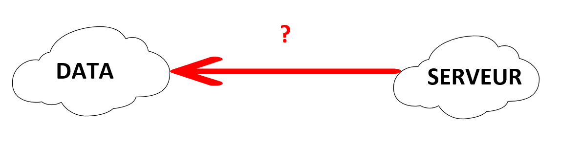

I will soon be setting up a WAPT Enterprise server and I have a small question regarding firewall rules.
The WAPT documentation prerequisites do not include a flow Source: WAPT Server Destination: Client Computer
So I was wondering how, from the console, an action like forced deployment could be performed?
Screen forum WAPT.png (21.98 KB) Viewed 9161 times
Sincerely,
Eliott.
Messages: 2027
June 23, 2022 - 12:38
The client opens a WebSocket connection to the server. The server then reuses this WebSocket connection to send notifications, such as when an update is launched. Therefore, there's no need to open a firewall connection since the client initiates the connection.
