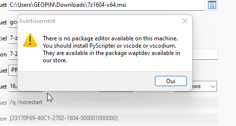

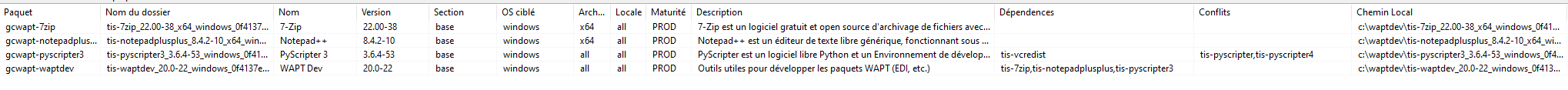

Does it need to be installed on the machine hosting the console? If so, how do I do it because it appears in Package Development but not in the private repository.

you need to install the waptdev package on the machine where you have a configured console; it will be simpler (ideally, you should use a different machine than the one you use for daily management, but this will do for now).
The waptdev package will install pyscripter3 on your machine. Pyscripter is launched by default with elevated privileges. Depending on the user account used for the console and local UAC configuration, you will need to enter a user account with local admin rights (necessary for testing the installation).
In pyscripter, you can test the installation and uninstallation of the application. After that, to upload the package, the best way is to use the console interface, in the "Private Repository" tab, and select "Build and Import Package into Repository".
