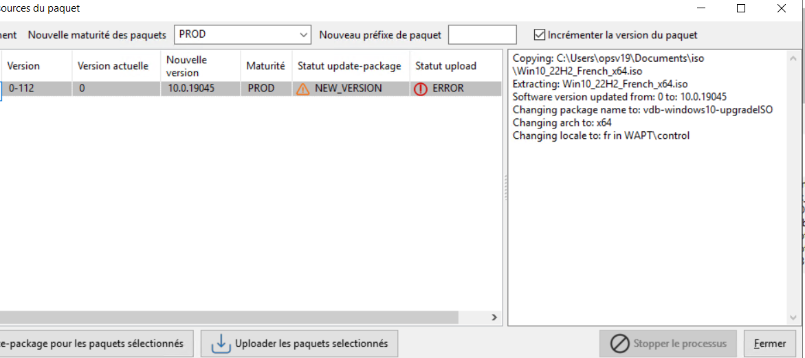

I took a screenshot,
I don't know where the upload logs are located
- Screenshot_20221226_083216.png (142.41 KB) Viewed 5018 times
Thank you for your help

does it work when you run `update_package` from a PyScripter?
Regards,

We do have a small problem with this package regarding the upload.
The update package runs correctly through the console, but because it's placed in the temp directory, it reaches a filename length limit, and the build fails.
Running the update package through the code editor places the package in c:\waptdev\, and therefore it works because the path is shorter.
We need to find a solution,
Simon.

The problem has been fixed internally on the master version 2.3, so it will work in the next version

I've just returned to work
, and it works via PyScripter.
Thank you for everything.
