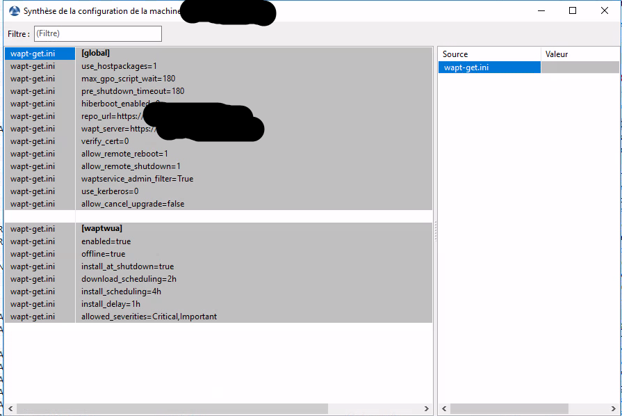

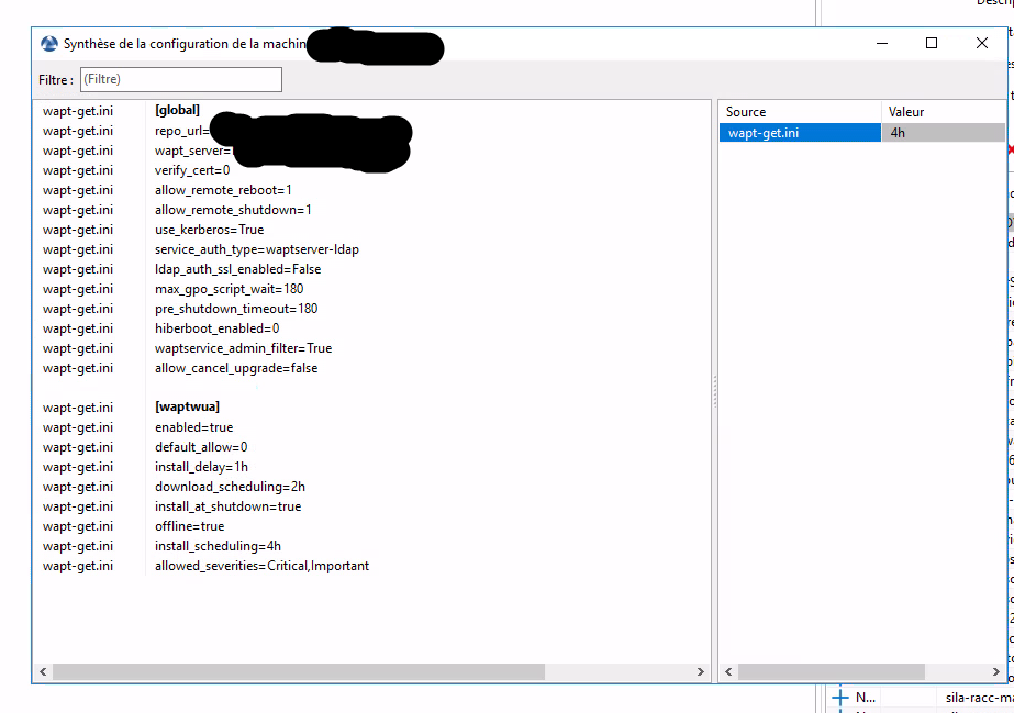

wat-get.ini from the test station:
wat-get.ini production workstation:

Yes, it should work automatically. You do have `service_auth_type=waptserver-ldap` on the test machine, but not on the other one. Was the test performed on the test machine?

thank you for these replies. I do have the line "service_auth_type=waptserver-ldap" in [global] on the machine where I'm doing my test. I'm not putting it on the production machines yet because I'm not sure I fully understand all the ins and outs of this configuration.
