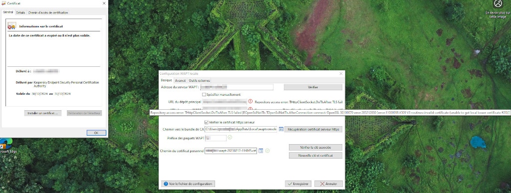

I reset my console to its initial configuration to retrieve the certificate stored in C:\Users\xxxxxx\AppData\Local\waptconsole\ssl\server\xxxxx.crt, which is still invalid due to the expiry date.
For the test, I completely disabled Kaspersky on my machine, but the problem persists.

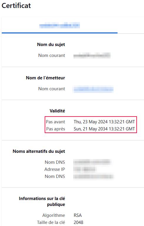

In the console settings, completely by chance I clicked on the icon to the left of the "Repository access error..." message. This opened the browser with the certificate information
For this one, there's no date issue. I admit I'm a bit lost between package certificates and console certificates :(

Published: January 7, 2025 - 10:27 AM
by sfonteneau
Hello
, I think the certificate mentioned here:
is the Kaspersky certificate that was retrieved at some point (and is still expired). Could you check?

could you please click the "Retrieve HTTPS Server Certificate" button to force the retrieval of the correct certificate?
Regards,
Re: Expired Certificate
Published: January 7, 2025 - 3:38 PM
by flipflip
Can you click on the "Retrieve HTTPS Server Certificate" button to force the retrieval of the correct certificate?
Sometimes the simplest solutions are the best ;)
I renamed the old certificate and clicked on Certificate Recovery... And magically, everything is working perfectly with the certificate valid until 2034.
