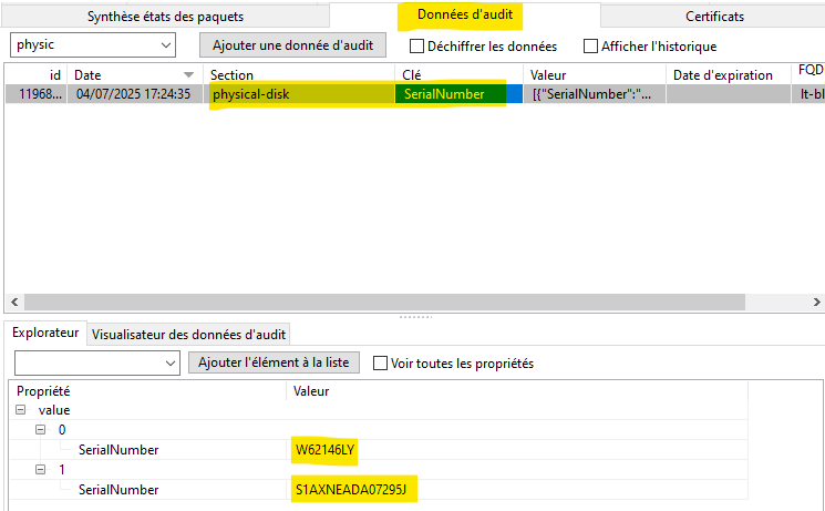

Sorry, AdapterSerialNumber wasn't included in the package. I'll run a quick test and get back to you
Re: Retrieving the serial number of the NVMe drive
Published: July 4, 2025 - 5:28 PM
by blemoigne
We should make this kind of package:
Code: Select all
# -*- coding: utf-8 -*-
from setuphelpers import *
    pass
def audit():
    result = run_powershell('Get-PhysicalDisk | Select AdapterSerialNumber',output_format='json')
    WAPT.write_audit_data_if_changed('Physical-Disk','AdapterSerialNumber',result)
    return "OK"
The data will appear in the Audit Data tab

Published: July 7, 2025 - 11:33
by blemoigne
I don't have an AdapterSerialNumber on my machine, but my tests are correct with SerialNumber:
Code: Select all
    pass
def audit():
    result = run_powershell('Get-PhysicalDisk | Select SerialNumber',output_format='json')
    WAPT.write_audit_data_if_changed('Physical-Disk','SerialNumber',result)
    return "OK"
