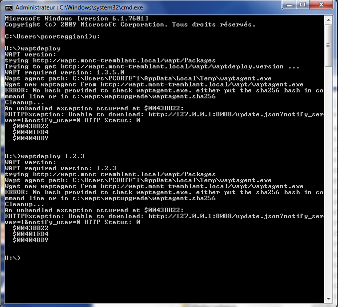

Hi,
Manually on a workstation, this does not work (see photo)
Order under back
Order under back
I tried without specifying the version the first time, so it's using my waptdeploy.version file, the contents of which are below:
1.2.3
http://wapt.mont-tremblant.local/wapt/waptsetup.exe
The second test involves entering the version number, but nothing works.
I also see a download attempt on 127.0.0.1:8088 on this remote machine?

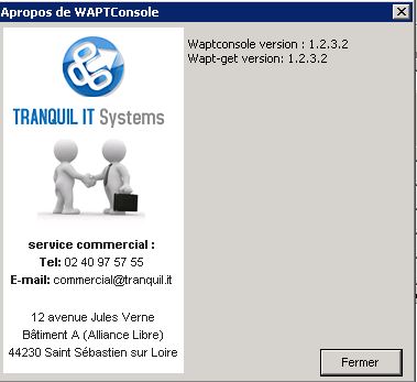

Here is the version my console gives me below:
Thank you for your help

by sfonteneau
Good morning
Initially, I recommend that you deploy version 1.3.5 (the latest version)
http://wapt.tranquil.it/wapt/releases/wapt-1.3.5/
With WAPT 1.3.5, it is necessary to include a checksum in the script parameters. This ensures that waptdeploy will not launch a tampered/corrupted installer.
Therefore, you need to include this type of argument with your waptdeploy:
Code: Select all
waptdeploy.exe --hash=0e592e9113ebe2e040ad945d7b887fc69843addb5950bf0dade20458be529a1d --wait=15 --minversion=1.3.5
On a Wapt Linux server, you can retrieve this hash with the command:
sha256sum /var/www/wapt/waptagent.exe
On a Windows WAPT server, to recover the data, I recommend installing the latest version of 7-Zip (15.14.00.0) on the Windows WAPT server. Then, right-click on the waptagent file located in c:\wapt\waptserver\repository\wapt\waptagent.exe and click on CRC SHA, then on sha-256.
