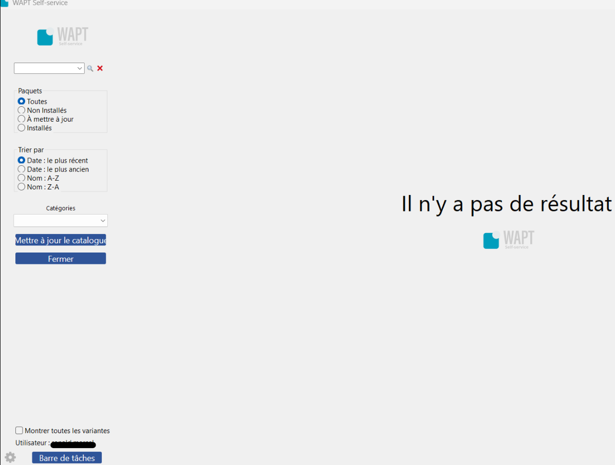

We have the following problem with users of a Forticlient VPN.
Accessing their Self-Service system when connected via VPN displays no results, even though the machine is reachable via the console.
However, if the selservice is reconnected, access is restored about half the time.
Here is a list of all the actions we have already taken:
  • Traffic audit = No traffic is blocked, either to the primary or secondary repository on ports 80 and 443.
    Agent uninstalled and then reinstalled.
    WAPT services stopped and then restarted.
If you have any ideas for finding a solution, they would be more than welcome. :D
