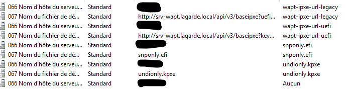

I would say ipxe
Screenshot 2026-01-20 134348.png (23.07 KB) Viewed 50119 times
Re: OS Deployment - Freezes
Published: January 20, 2026 - 2:55 PM
by sfonteneau
No, you're currently using "snponly.efi"
, so it's using the HP firmware's UEFI (SNP) network stack.
You can try switching to "ipxe.efi" as the value instead of "snponly.efi";
this will use the native iPXE driver.
Normally, the opposite is often better, but anyway...
