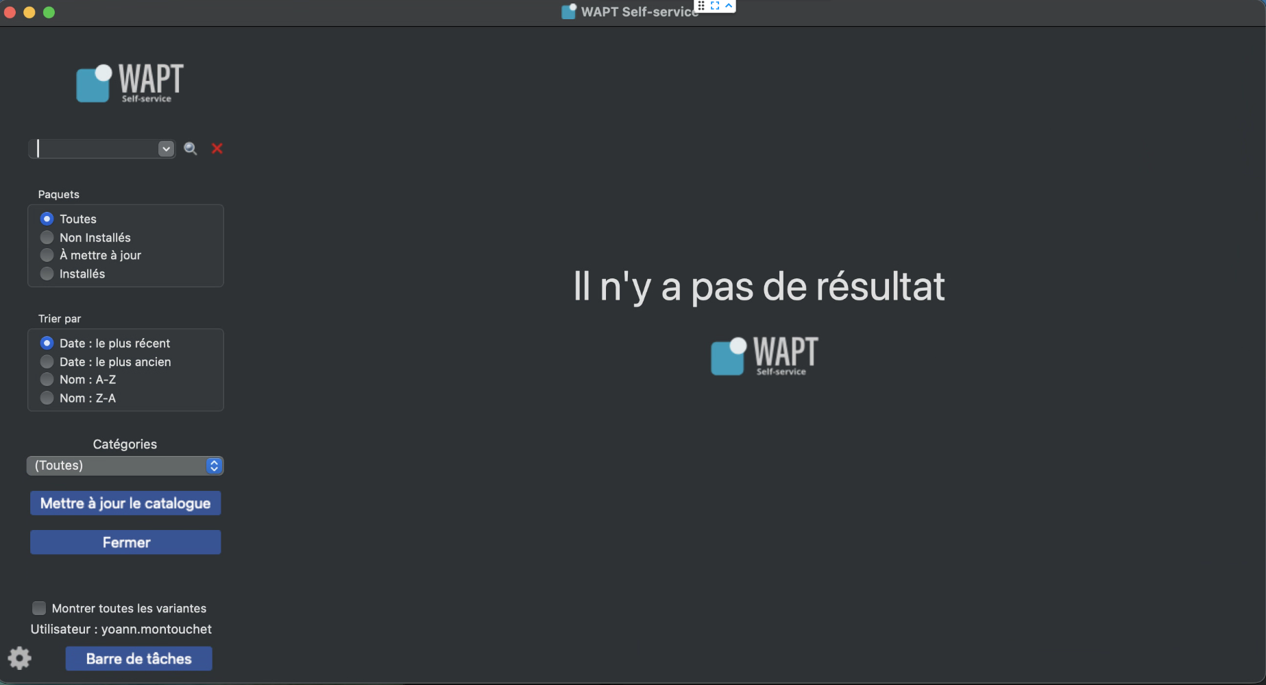

However, the self-service feature is not working. It consistently displays "No results found":
Screenshot 2026-03-02 130303.png (222.37 KB) Viewed 10838 times
I know we managed to configure another Mac previously, and it's still working today. But I can't figure out what's missing on this one... Is there a log somewhere we could use?

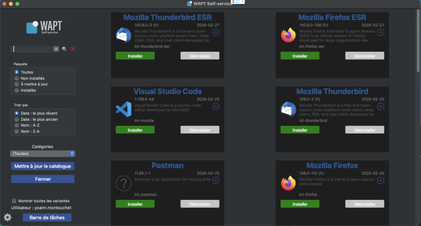

But this will be quick: I tried changing the log level to debug. Then I restarted the wapt service, and after that, I don't understand I can now see the content displayed...
Screenshot 2026-03-02 132241 (Small).png (155.2 KB) Viewed 10821 times
In terms of actions taken today, I only see two things: installing the self-service package and then restarting the wapt service. Could these two elements explain why it's working now? 🫣
Otherwise, I don't understand...
EDIT: Okay, that's it, it was adding the self-service package that unlocked it, potentially followed by restarting the service... I'll make a note of it in my documentation!

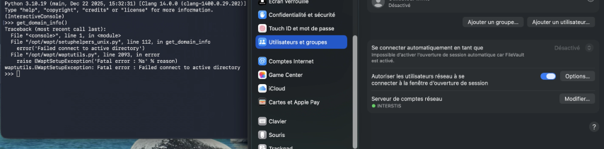

That's strange, it seems he can't connect to AD even though it's reachable, and I was able to add an AD user on my end:
Screenshot 2026-03-02 145457 (Small).png (131.96 KB) Viewed 10779 times
I'm going to try rebooting and starting over
EDIT: It's the same after rebooting, with the VPN connected and even after restarting the service. Self-service works, but Active Directory seems unreachable
Code: Select all
Python 3.10.19 (main, Dec 22 2025, 15:32:31) [Clang 14.0.0 (clang-1400.0.29.202)] on darwin
(InteractiveConsole)
>>> get_domain_info()
  File "<console>", line 1, in <module>
  File "/opt/wapt/setuphelpers_unix.py", line 112, in get_domain_info
    error('Failed connect to active directory')
  File "/opt/wapt/waptutils.py", line 2093, in error
waptutils.EWaptSetupException: Fatal error : Failed connect to active directory
