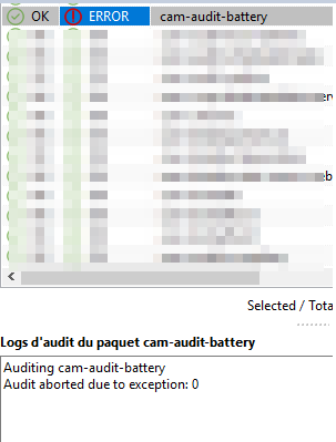

I tried to use the tis-audit-battery package, however the audit returned the following error:
The package is successfully deployed on a laptop. Do you have any idea why this error is occurring?
Thank you so much

Hello Johan,
Could you please run the following command in a cmd.exe window using your admin account?
Code: Select all
wapt-get audit cam-audit-battery -l debug
If it works in the admin user account but not with the service, you should restart the audit with the LOCAL SYSTEM account (psexec -i -s cmd):
This should allow us to get a little more information.

Published: November 28, 2023 - 11:47 AM
by jpele
The crash was occurring on machines with only one battery; I've fixed it:
https://wapt.tranquil.it/wapt-testing/t ... EPROD.wapt
Regards,
Jimmy

Hello Jimmy,
Indeed, it works perfectly now :)
Sincerely
