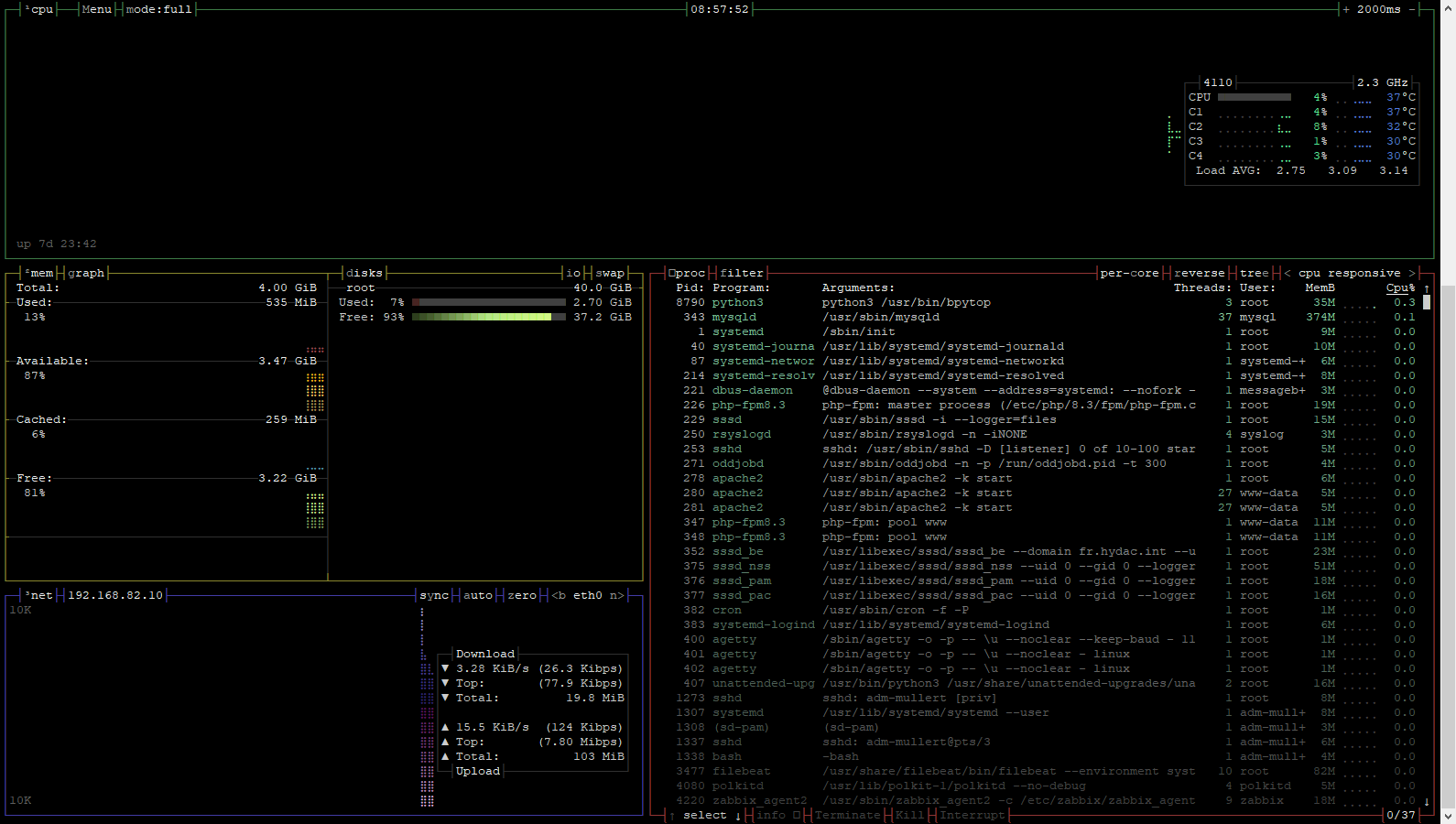

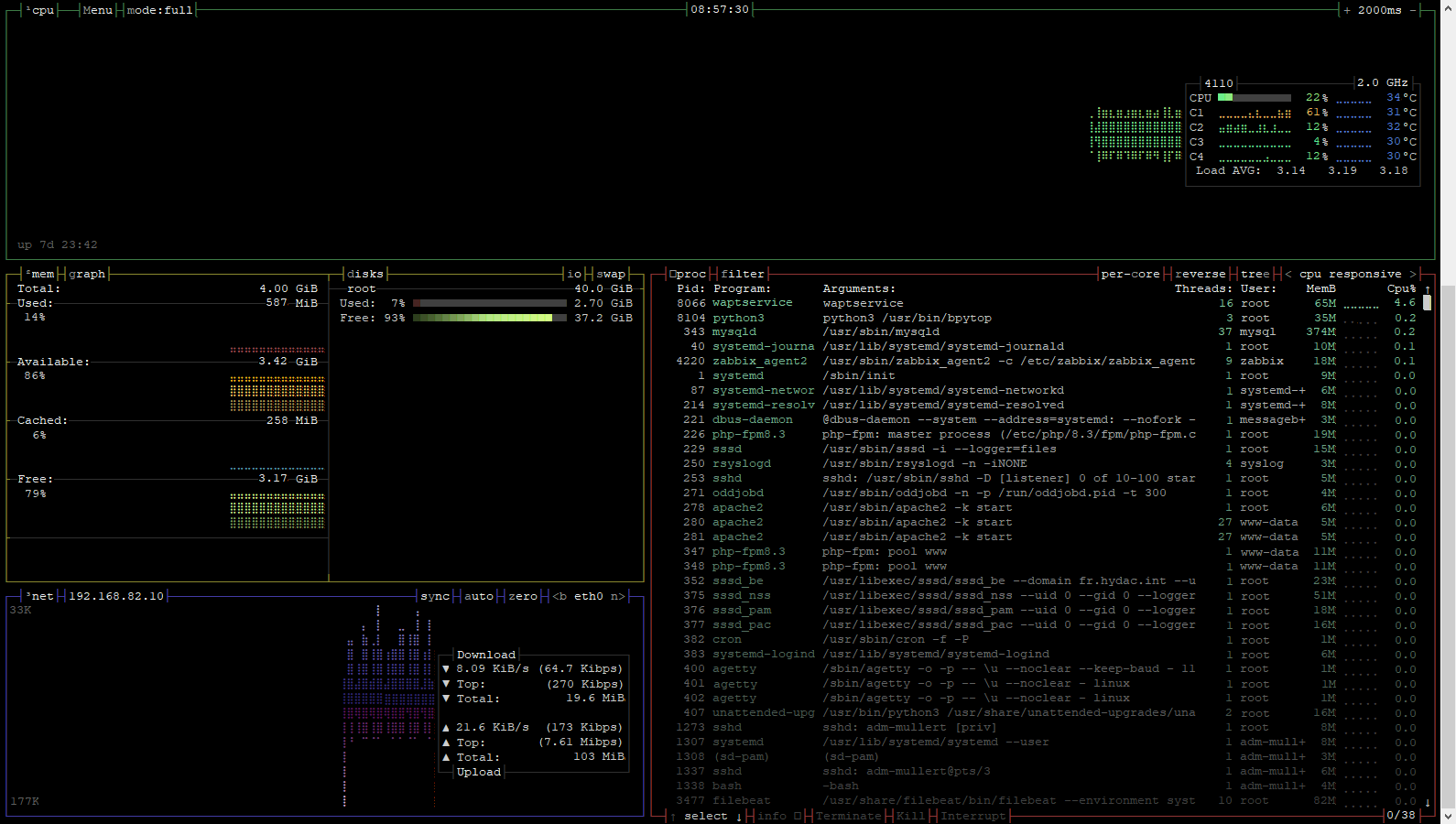

Hola a todos,
Desde esta mañana he notado una actividad anormal de la CPU en mis máquinas Linux (ubuntu/debian).
Acabo de notar que instalaron la última actualización de WAPT 2.6.0.16881 durante la noche, lo que parece estar afectando el funcionamiento del agente.
Adjunto capturas de pantalla del uso antes y después de detener el servicio Wapt; la diferencia es notable. También incluyo una captura de pantalla del estado en la consola.
Cuando intento una actualización wapt-get en las máquinas, este es el resultado:
Código: Seleccionar todo
Using config file: /opt/wapt/wapt-get.ini
Nothing to upgrade
2025-02-04 08:58:46,341 WARNING Host on the server is not known or not known under this computer name (known as None). Trying to register the computer...
2025-02-04 08:58:49,342 WARNING Host on the server is not known or not known under this computer name (known as None). Trying to register the computer...
2025-02-04 08:58:51,664 WARNING Host on the server is not known or not known under this computer name (known as None). Trying to register the computer...
2025-02-04 08:58:54,749 WARNING Host on the server is not known or not known under this computer name (known as None). Trying to register the computer...
2025-02-04 08:58:57,502 WARNING Host on the server is not known or not known under this computer name (known as None). Trying to register the computer...
2025-02-04 08:59:01,060 WARNING Host on the server is not known or not known under this computer name (known as None). Trying to register the computer...
2025-02-04 08:59:03,257 WARNING Host on the server is not known or not known under this computer name (known as None). Trying to register the computer...
2025-02-04 08:59:05,931 WARNING Host on the server is not known or not known under this computer name (known as None). Trying to register the computer...
2025-02-04 08:59:08,402 WARNING Host on the server is not known or not known under this computer name (known as None). Trying to register the computer...
2025-02-04 08:59:11,145 WARNING Host on the server is not known or not known under this computer name (known as None). Trying to register the computer...
2025-02-04 08:59:13,385 WARNING Host on the server is not known or not known under this computer name (known as None). Trying to register the computer...
2025-02-04 08:59:15,909 WARNING Host on the server is not known or not known under this computer name (known as None). Trying to register the computer...
Gracias por tu ayuda, mi servidor está empezando a sobrecargarse :rollo:
