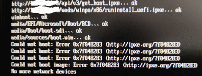

Hello, I'm writing again to get back to you. Following the various messages, I've made the necessary changes, and it's improved. It boots correctly and I get to the menu, but when I choose any of the options, I always end up with the same thing and I'm stuck there:
Untitled 1.gif (39.95 KB) Viewed 12407 times
I'm completely stuck here, I don't understand. I've tried starting all over again from scratch and it's still the same
