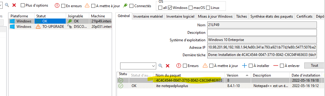

A long time ago I installed version 1.8 of WAPT to test it on a machine.
Since then, the subject had fallen into disuse, and now the opportunity has arisen again. The original machine is switched off.
So I decided to reinstall Discovery version 2.2 and start from scratch.
During the agent installation on a test machine, I see that a package is installed in addition to the test Notepad++.
No matter how many times I uninstall it, it keeps trying to put itself in the dependencies and I don't understand where this could be coming from.
Code: Select all
Installing 4C4C4544-0047-3710-8042-C6C04F463633(=7)
Delete C:\Program Files (x86)\wapt\cache\4C4C4544-0047-3710-8042-C6C04F463633.wapt
Installé : 4C4C4544-0047-3710-8042-C6C04F463633(=7)
I'm a bit lost on how to analyze/remove this "unwanted" package.
Do you have any leads?
With thanks :oops:

this is the "machine" package, i.e., the package containing the list of packages that the machine must have installed (see documentation). The UUID in question, which is used for the name of the "machine" package, corresponds to the machine's BIOS UUID.
Regards,
