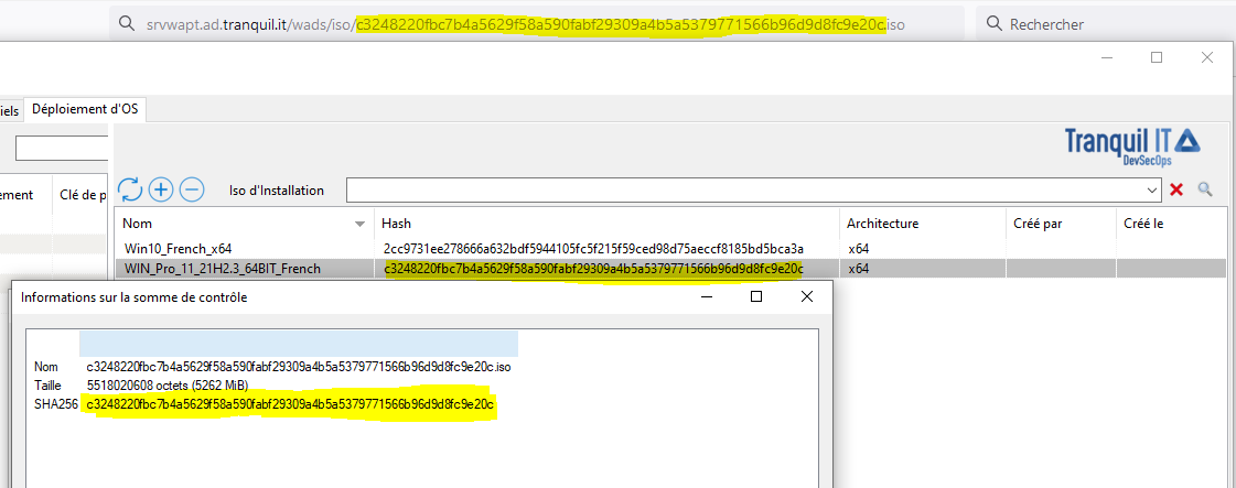

I've encountered yet another error message. I think it's a problem with the ISO image...
Picture (open the image in a new tab to see it more clearly)
Regards,
Erman
Messages: 2380
June 14, 2022 - 12:31
Yes, indeed.
The hash of the downloaded ISO doesn't match the advertised hash.
Your Windows 10 ISO is only 3.1 GB? There might have been a problem during the ISO upload?
The filename, and therefore the URL, corresponds to the SHA256 hash, so clearly the file's hash doesn't match.
Therefore, either there was a problem during the upload, or there was a problem during the download via WADs.
