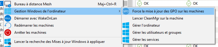

Which console are you referring to? The WAPT console? If so, how? (I haven't seen that option on the console)You can force the refresh by using the "force GPO" option from the console

Hello
, yes, from the WAPT console, refreshing the GPOs also forces the groups to refresh.
- Attachments
- Capture.PNG (20.1 KB) Viewed 9760 times
